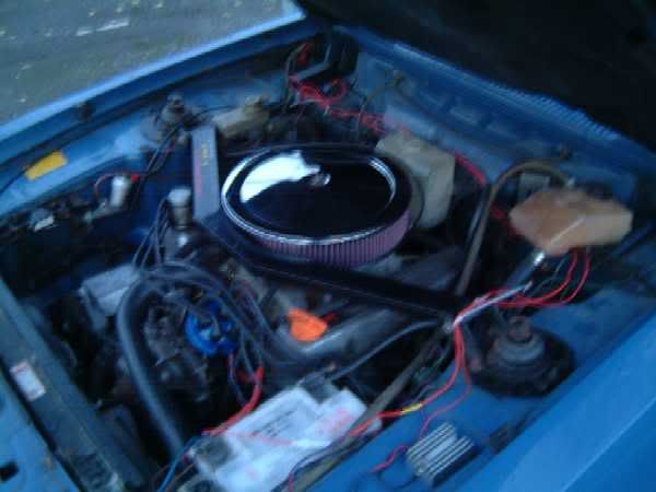

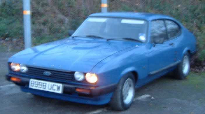

Youre damn right v8s are cool my brother owns a capri with a rover SD1 v8 lump AND it has a holly four barel carb setup this car is sooooo much fun. . . . .
