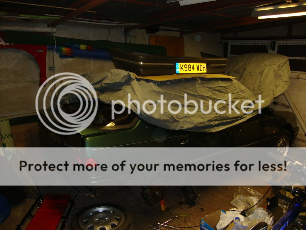

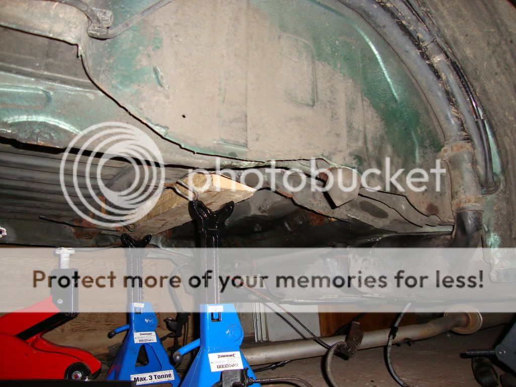

My Goodwood is now tucked away in the garage for a lot of work this winter so its ready for some of the shows coming up this summer .
Rear beam is off and in bits , fuel tank down , luckily the underside is in good nick , only surface corrosion apart from one of the inner sills in the usual spot .
