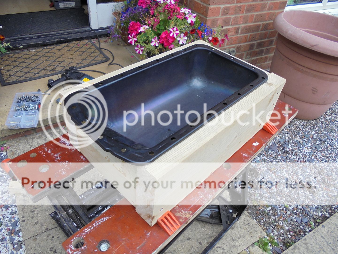

Postby miles1234 » Tue Jul 28, 2015 12:42 pm
Used a spare sump to get the size of the cradle correct , the oil temperature sensor will need to be left off while it sits in it though .Should make it safer to store the engine so it does not keep trying to topple over and no damage to the sump either .Have made it so the flywheel can be fitted and will overhang that end .
